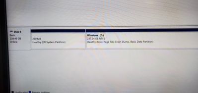

I have an hp pavilion 690-0073w and I tried setting up an SAS hdd, I have all the right cables and when I connect them to the SAS hdd, the SAS hdd shows a green light (I'm assuming that it works), however the SAS hdd doesn't show up on the disk management in windows 10. Does anybody know how to fix that? Is it because the motherboard I have isn't compatible?(I have a 843b lincs motherboard)

No, it was still not detected. The SAS drive is 1tb, the ssd is 256gb. It probably has to do with the motherboard and the cable, also the hdd is on even if I don't connect the blue part to the motherboard.
