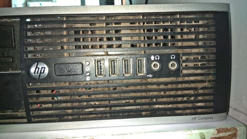

I wanted to ask can this (pic) might be the problem
09-20-2021 11:51 PM - edited 09-20-2021 11:56 PM
@Ethan045627 -- I don't understand what the image is trying to show, unless you are trying to show that each "hole" in the grid is stuffed-full with dust. If cool room-temperature air cannot be pulled into your computer, it will overheat.
Turn the computer off. Disconnect the power-cord. Carefully remove that front panel, and remove the dust.
Probably, the heatsink (between the CPU and the fan) also is completely clogged, causing the CPU to overheat.
Probably, the inside of the power-supply is also dust-clogged.

and I cleaned the (pic) area and now it is fresh.
