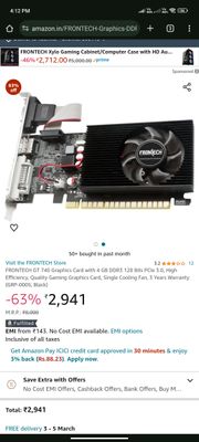

i bought an GT740 gpu  for my pc does it support this HP Compaq pc please anyone tell me I need to make this pc again functional. In performance

Yes the PSU. Is 240W so you mean can I put this gpu? So then can I put GT740 4GB ddr3 or GT1030 GDDR4 which is good I have two old gpus then what should I put?
