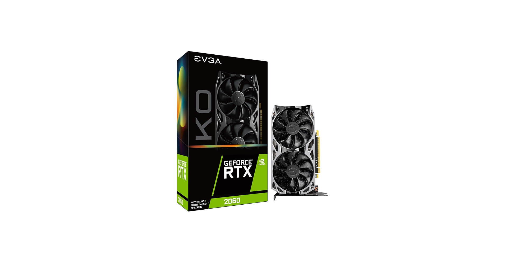

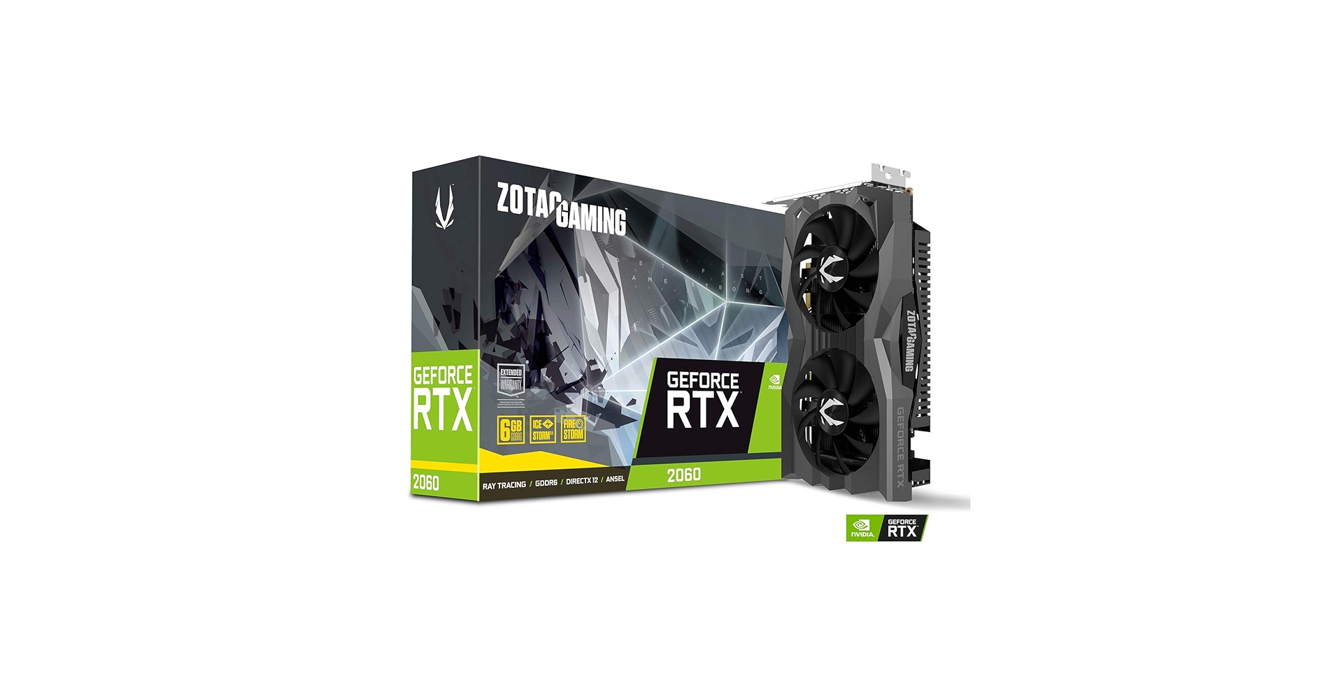

The computer would restart with a message Error Image. I don't know how to determine if the graphics was the cause. I will keep the USB hub in mind. I will keep the PS supply save in my bookmark incase I decide to purchase it. What about for the RTX 2060, would that even fit or should I just stick to the 1660Ti ? I am realizing that a 32inc TV isn't working out for me dealing with audio delays and having to switch back and forth. Hopefully that could help towards lowering power consumption and instead will use two monitors. I was hoping that my laptop 16gb RAM can be use on the desktop, but read about So-DIMM and the one you recommended. I guess LAPTOP and DESKTOP doesn't use the same RAM.

The 2060s linked are both shorter in length and height than my mini 1070 mini, my GPU uses 150w, the 2060 uses 160w, should be no issue if you don't overclock and use stock voltage. With that said my case did touch the cables for my 1070 but 2060 is much shorter so no problems.
https://www.amazon.com/ZOTAC-GeForce-192-bit-Graphics-ZT-T20600H-10M/dp/B07TDN1SC5/ref=sr_1_3?dchild...
https://www.amazon.com/EVGA-06G-P4-2066-KR-GeForce-Gaming-Backplate/dp/B083GH7LXW
