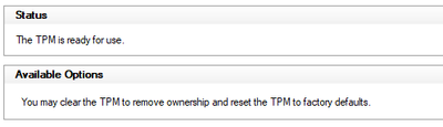

I assume from the error description that your comment "Make sure that 1.2 is active and enabled and you have "taken control", has been complied with? This is what it says when I run TPM.MSC
I assume that that means it's active and ready for use but do I have control and if not, what would I need to do to get control? I note there's a 'clear TPM' option but would that give me control.
[edit] if it's any help, this is what the log says
