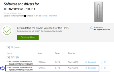

@MSNHottinger,
Two things: change the "PCI VGA Palette Snooping" to disable, and perhaps more importantly, upgrade your BIOS to version: F.27 Rev.A (May 30, 2019) for your Odense2-K motherboard (SSID: 82F1):
Link: https://support.hp.com/us-en/drivers/selfservice/hp-envy-750-500-desktop-pc-series/13823509/model/15....
