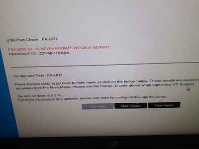

Thanks for the response Eric. I have tried all software related fixes, from USB driver reinstallations to adjust power management to the USB ports from the driver tabs in device management.  Nothings worked. I suspect it could be a hardware failure some where on the board.
I ran some tests in the UEFI diagnostics. And got this report.
FAILURE ID : PLN7W4-A1K8MF-WPQE21-8D4N03
The link shown is unavailable.
Can please help with what this means.
