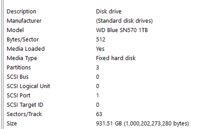

[edit]  There is another possibility.  On the system that can boot up please run "msinfo" and verify that the bytes per sector of your NVME is 512 and not 4096

3. The byte sector of nvme is 512
