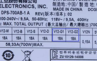

I got good news for you: the 700-watt power supply's 6-pin PCIe power cables are each capable to deliver 12V x 18A = 216-watt of power:
Meaning, you can use 6-pin to 8-pin PCIe power adapter cables, like I did in my HP Z440 Workstation upgrade project: Solved: Upgrading an HP Z440 Workstation - HP Support Community - 9015888.
You are correct: a 700-watt power supply provides ample power for an RTX 4070, not just in theory.
