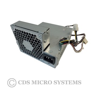

Examples:
The case of the power-supply is metal, not plastic.
The 110V AC power-cord connects to the exterior part of the power-supply case; it does not connect to the chassis fan assembly.
HP-Compaq-Elite-8000-8100-8200-240W-SFF-Computer-Power-Supply-503375-001
> Image from CDS Power Systems.
Yes, that is the power supply -- it is not the chassis fan assembly
