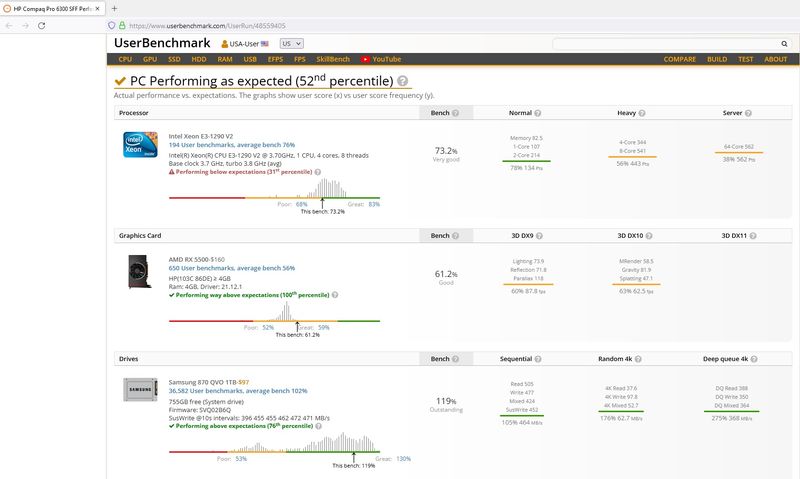

Dear Forum, utilizing just the AMD Radeon Adrenalin v. 21.12.1 software, I reached what I think is approaching the upper stable and sustainable overclocking performance limit for the HP AMD Radeon RX 5500: 61.2% as per UserBenchMark [dot] com -see: HP Compaq Pro 6300 SFF Performance Results - UserBenchmark
Here is an easy to follow overclock RX 5500 reference link: How to OVERCLOCK and UNDERVOLT RX 5500XT | ADRENALIN 2020 Easy Guide, Tutorial - YouTube
Disclaimer: Quite predictably, HP does not encourage overclocking of any computer component. And I quote as per HP:
"Please note that HP does not support any kind of overclocking of GPUs or CPUs using either the bios or any other software as it is not recommended by HP. HP has designed and built the computer to ensure optimal functionality of the computer for regular users and consumers. Overclocking processors could damage the computer’s internals causing heat and other related system board damages and therefore HP does not support it.
It is done at the customer’s own discretion and certainly not recommended by HP. That is one of the reasons why the Bios options for overclocking is also restricted."
Btw, for a rather blunt Forum discussion on overclocking, this link won't disappoint: HP says use Intel Extreme Tuning Utility for overclocking - HP Support Community - 5903597
