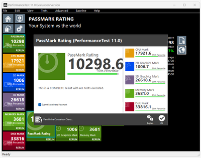

Ran the PassMark V11.0 build 1003 Performance Test:
Overall PassMark V11.0 build 1003 Rating: 10,298 - 97th percentile
CPU Mark: 17,921 - 75th percentile
2D Mark: 1,006 - 88th percentile
3D Mark: 26,618 - 99th percentile
Memory Mark: 3,681 - 95th percentile
Disk Mark: 33,816 - 98th percentile
PassMark Performance Test download: https://www.passmark.com/downloads/petst.exe.

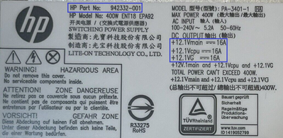

As discussed in Solved: Re: Sff motherboard new gen support - Page 3 - HP Support Community - 8820824, removed the 250-watt power supply (p/n: L08417-004) and installed the 400-watt power supply (p/n: 942332-001).  My desktop powered on without any issues, even though the 400-watt PSU's "P2" 7-pin power connector's wire color coding was a little different, as it lacked the purple wire: red, white, black, green, grey, purple empty, black.  The 400-watt PSU's 8-pin PCIe power cable is not needed, and tucked away.
The reason why I swapped power supplies -even though the current config doesn't need it, is because I am planning to install an i9-9900KS, which has a whopping 127-watt TDP, devouring 32 additional watts compared with the i9-9900KF (TDP: 95-watt) currently installed.
An additional 150-watt under the proverbial hood would allow -or so my thinking goes, to provide sufficient power to feed Intel's top 9th gen i9 processor.  My RTX 3080 12GB graphics card is powered with a synced 850-watt external fully modular power supply, but the "internal components" of my HP EliteDesk 800 G5 SFF are powered through the onboard power supply.

Doggonit, a couple of hours ago today whilst watching a YouTube video, this desktop abruptly crashed.  Actually, not crashed, but like the power switch was turned off without warning.  Since this PC is connected to a large UPS, that couldn't have happened.  Anyway, I ascertained that the UPS was indeed A-OK, as well as the secondary synced power supply.
I swapped the 400-watt power supply back to the 250-watt power supply, and voilà, this rig powered on just fine.
Not clear why the 400-watt PSU failed -it couldn't have been an excessive power draw, as the 8-pin PCIe power cable wasn't used, and the i9-9900KS hasn't been installed yet.
Also, a close inspection of the aforementioned power supply didn't provide any clues either: observed no smoke, hot spots or burn marks, discolored, bulging or leaky electronic components, or little e-gremlins trying to scamper off.
Informed the eBay Seller and requested a replacement power supply.  If they boondoggle (...) me, eBay will refund me one way or another.

Dear Forum,
To give praise where praise is due: Seller agreed to have me return the defective unit for a full refund and also provided a free USPS priority mail shipping label. Will think about where to go from here, perhaps I will purchase the 500-watt SFF power supply (p/n: L77487-003) instead.

most HP power supplies for workstations and many business models do not use single rail power supplies where any unused wattage is available on any output cable
they use multirail type supplies and as such the wattage of each subsection is fixed so if the cpu wattage is 100 watts and the GPU wattage is 100 watts but you are only using 50 watts the remaining 50 watts is not available to the cpu power subsection
@DGroves,
You brought up an excellent point.  That's why I mentioned switching over to the 500-watt power supply which does provide more juice per power rail compared to the 250-watt power supply: 18 Amps vs. 16 Amps, which is 12.5% more power, which translates into 24 additional watts each per rail:
To reminisce: the failed 400-watt (p/n: 942332-001) just like the 250-watt power supply also provided 16 Amps per rail, and turned out indeed not to be a power (wattage) improvement per rail:
