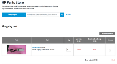

Something else, though: if you prefer a 500-watt power supply, there is an HP Envy TE01 compatible 500-watt power supply with p/n: L81009-800 "Power Supply - 500W WS20 FR Gold" (see: HP PartSurfer) :
Only problem is that these particular power supplies are somewhat expensive.  It so happens that purchasing this power supply directly from HP (in stock!) is the least expensive option:
