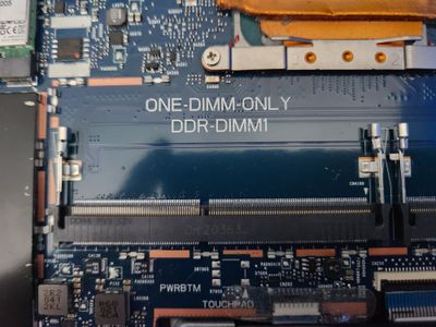

Am I able to install another memory chip? If so, how?
The second slot that is mostly missing from your screenshot doesn't have the same clips and slot as the first one?
If not, then your notebook can only support one memory chip.

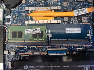

 Here's a photo of both RAM slots, is this what you mean?
It looks to me like you can install another memory chip in the empty slot.

The model is 14m-dw1013dx.
Below is the link to the product specs for your notebook.
HP Pavilion x360 m Convertible 14m-dw1013dx Product Specifications | HP® Support
You can upgrade the memory and I see that it comes with a 128 GB M.2 SATA SSD.
This would be a pretty cheap way to upgrade the notebook to get a decent amount of performance.
Install an 8 GB DDR4-3200 MHz memory chip and double the memory to 16 GB.
The Crucial memory report for your notebook indicates it can support up to 2 x 32 GB of memory, but that would be overkill.
HP - Compaq Pavilion x360 14m-dw1013dx | Memory RAM & SSD Upgrades | Crucial.com
The second thing you could do would be to replace the 128 GB SATA SSD with a 500 GB NVMe SSD which will be around 4 to 5x faster than the SATA SSD.
Crucial P3 500GB PCIe M.2 2280 SSD | CT500P3SSD8 | Crucial.com
So, for less than $60, you can pep up your notebook quite a bit.
