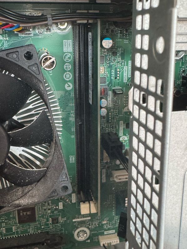

hi there
The torx 15 screwdriver was absolutely spot on! Got the back off within 20 seconds.
This is the RAM i currently have.

Thanks again for the advice. In regards to installing RAMWhatsApp Image 2025-03-26 at 16.05.32_a4d84479.jpg
I assume the gold part goes in the groove and clicks in with the sticker part facing the same way as the existing RAM? do you need to push hard?
@djr_uk,
Correct, watch the RAM notches and push straight down until it goes 'snap' twice on either side: and again, watch the YouTube video I posted earlier at timestamp 6:40: https://www.youtube.com/watch?v=rKyLdGMqezw&ab_channel=TechNitWit.
Kind Regards,
NonSequitur777
