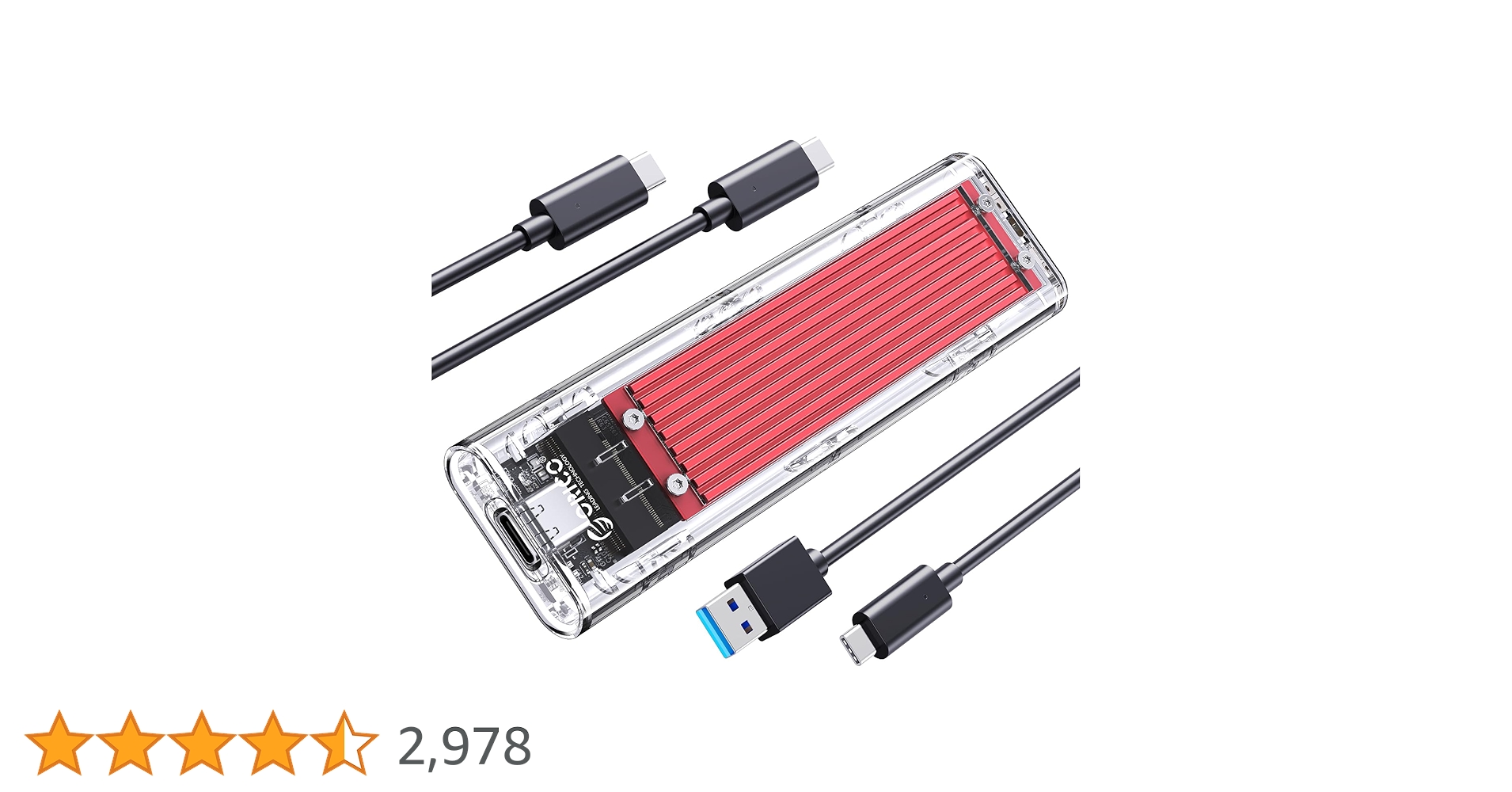

Also would it be possible to run another SSD via a USB adaptor like this? If so, would it have to be exactly the same?
https://www.amazon.co.uk/gp/product/B07RFJM494/ref=ppx_yo_dt_b_asin_title_o00_s00?ie=UTF8&psc=1
I know on my old DC7000p it would only run one SSD, will the Elitedesk 800 G3 run several?

If you wish to run another drive on a USB adapter, the adapter may not give SSD advertised speed, but it should run Ok.
