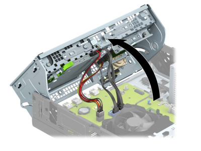

I'm talking about an intenal 3.5" HD I have.  It has a data cable and another cord, that I thought is called a power cord.  The cord I need is the one that goes from the HD to the blue connector in the computer.
In this image, I need the cord that goes from HD to the blue connectors on the main board.

The cable with its connectors is the power cable of the 2.5" SATA cable set.

The blue connection on the motherboard means that it is SATA3.
I would have ordered one  that was SATA3 and with one end straight and the other at ninety degrees.
The one you ordered has two ninety degree connections.
Both ends of the SATA cable with ninety degree connectors probably will be unlikely to fit on your motherboard.
