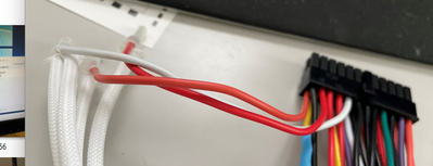

Pictures of two wiring assemblies that worked follow.  The single white wire to the 2x2 connector is ground.  The red and orange are each 12.  Those 3 wires are in the connector at the motherboard as the normal ATX does not supply 12 or ground to those pines
The enter adapter was made from 16agw ATX extension that was 18cm long.  I purchased a 2x2 power extension but a 4 pin molex is probably just as good.
The full adapter
A view of the ATX case with another adapter showing two liquid cooling setup:  GTX-1070 and ZEON X5680 in an NZXT case.
Just noticed one of the cooling fans is not spinning! I am glad I responded to your request for more deetails!
The above picture shows the same type of adapter as the previous where the extra 12v and ground came from one half of that 8 pin power cable as the X400 only used half
The following was made from 18 (or 20 ?) awg wire
