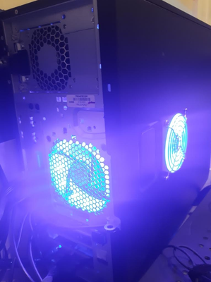

@djrwws,
I hope you are doing well.
Earlier in this discussion thread, I mentioned, quote: "increase overall airflow through your case AND especially through your CPU heatsink by adding one or more cooling fans".
With your indulgence, let me show you what that means to me, or rather, how I implemented this concept.
Here is exhibit "A": one of my heavily modified HP Z2 Tower G4 Workstations, as seen here: HP Z2 Tower G4 Workstation Performance Results - UserBenchmark.
Among other mods, I added two 90mm high-capacity (Blue-LED) cooling fans behind the front panel, one cooling fan on the side directly opposite the CPU heat sink (providing the CPU heat sink cool air directly), and one cooling fan on the bottom directly opposite the GPU (blowing in air directly into the GPU), and added 2-inch feet beneath the PC in order to give this fan some room to work properly.  All fans blowing air in the case -except the rear chassis fan and the power supply exhaust fan, which blows air out:
These cooling fans additions significantly lowered the overall CPU and GPU temps, especially when needed.  Unlike your PC though, all fans rev up very quickly and pick up quite a bit of speed/move lots of air when tasked to do so.

Wow, they're a bit bright.
There's not a lot of space in the Z6 G5 A chassis to fit more fans, no space at the front at all, but the side panel has vents and I think that I can fit 3x60mm fans to it, then I can add one internally to blow directly over the the cpu heat-sink.
