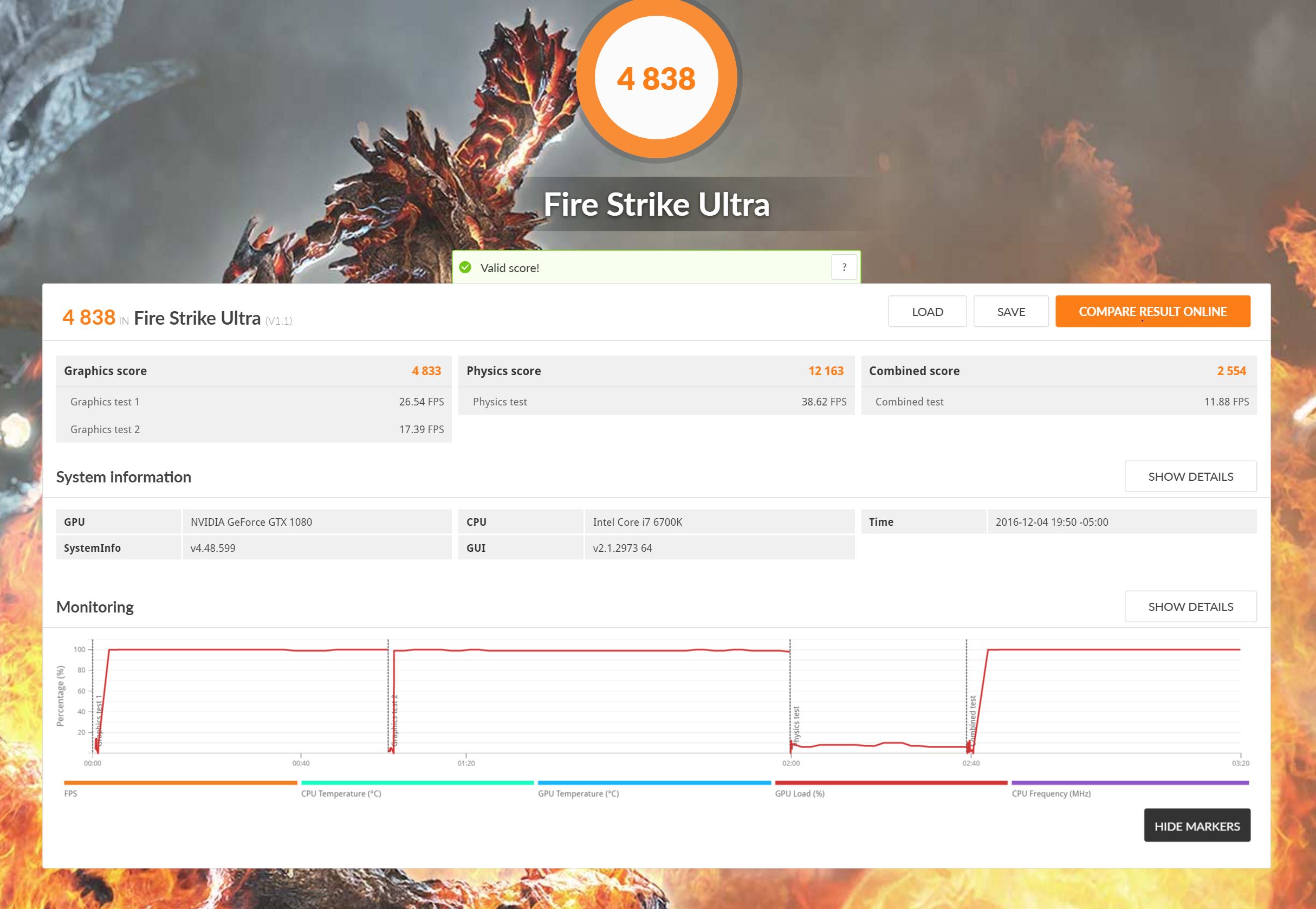

thanks. again. in fact, I think given the review, I cannot complain. I got very close to the Fire Strike Ultra score.
This is what worries me; several attempts at runnign 3DMark stress tests, even the basic Fire Strike (not the UItra for 4k), fail. I think it is throttling but I need to run it a few more times to confirm. but if anyone has suggestions, more than welcome.
resultfailedstress.3dmark-result
