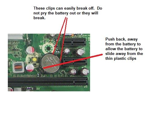

On the Mboard, there is a small white push button near the cmos battery, what i have to correctly change the battery.
I didn't find any information on HP support (the guide for my computer doesn't tell nothing more than change the battery)or on "youtube" about that button? Nobody seems to use it in explanations.

That button is used to reset the BIOS in case the system does not boot up following hardware change.
The battery needs to be replaced if the date / time keeps going back to 2010 or the date the computer was manufactured.
I have had to replace battery sockets that were damaged by improper removal of the battery.
