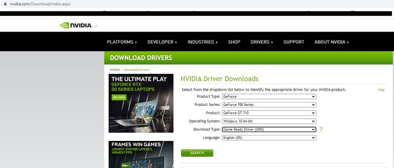

1.) Do you perchance have a different working graphics card to try out, and see if your desktop sees it?
2.) Uninstall the GeForce GT 710 (or any other) NVIDIA driver and REINSTALL from here: https://www.nvidia.com/Download/index.aspx
3.) Reboot computer and see if this resolved your issue.
