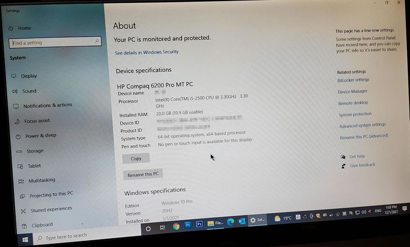

This post is an extension of:
I tried upgrading my system with Crucial RAM DDR3 2 X 8GB & soon TRY with Crucial SSD 500GB soon AFTER Clone c:/ disk soon
After being done with RAM now is FROM BLACK slot 1 TO white slot 4: 8GB-2GB-8GB-2GB
I have gotten just in the first boot with new RAM:
Is any problem with this?
After Pressed F1 --- booted to Windows 10 OS OK

12-01-2021 07:53 PM
you have a mismatched memory configuration
different sized ram in a bank/or memory modules in the wrong sockets
the 6200 has 4 dimm slots and each memory bank is two slots
what's confusing is that the 6200 can run in tri mode, where bank one is filled with two dimms the same size
and bank 2 is filled with only one dimm (same or different size) which needs to be in the correct slot
the primary memory bank is the one furthest from the CPU
note that the 6200 pro can support 32gb ram (HP manual was never revised and says 16GB)
here's a link to the correct ram placement order
https://www.manualslib.com/manual/575260/Hp-Compaq-6200-Pro-Sff.html?page=7
12-01-2021 10:18 PM
Here :
Says
So, install the 2 x 8 GB in the black sockets and put the 4 GB in the white socket
So is erroneous advice? The (Black...) 8-2-8-2
How order RAM Chips starting with Black further from CPU BLACK....?
12-02-2021 03:35 AM
ideally all dimms should be the same size
however you can install 2 dimms the same size in one memory bank and a different size in the other two, or just one different size (two different sizes in a bank is not allowed) which is what the 6300 pro allows, the 6200 should also allow this but to be safe stay with identical dimms if buying ram
follow the memory load order in the link i provided it PLAINLY shows that there is one black and 3 white sockets so it appears that you did not take the time to read before posting
12-02-2021 04:09 AM
the link
is for
6200 SSF
but my system is
6200 MT
And, I think were 2 BLACKS and 2 WHITE SLOTS: B-W-B-W --- I think
well...???
