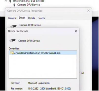

It could be the camera driver or the USB driver if the camera is connected to the USB. Many internal cameras are connected to the USB.
In the pictures below you would select the camera driver and then look for 'rollback'
If camera driver is the problem
If the problem is the wrong USB driver for the camera
If you cannot rollback the driver then try to find the best one or let windows try. One way is to just uninstall the camera and reboot as described in this official HP document..
