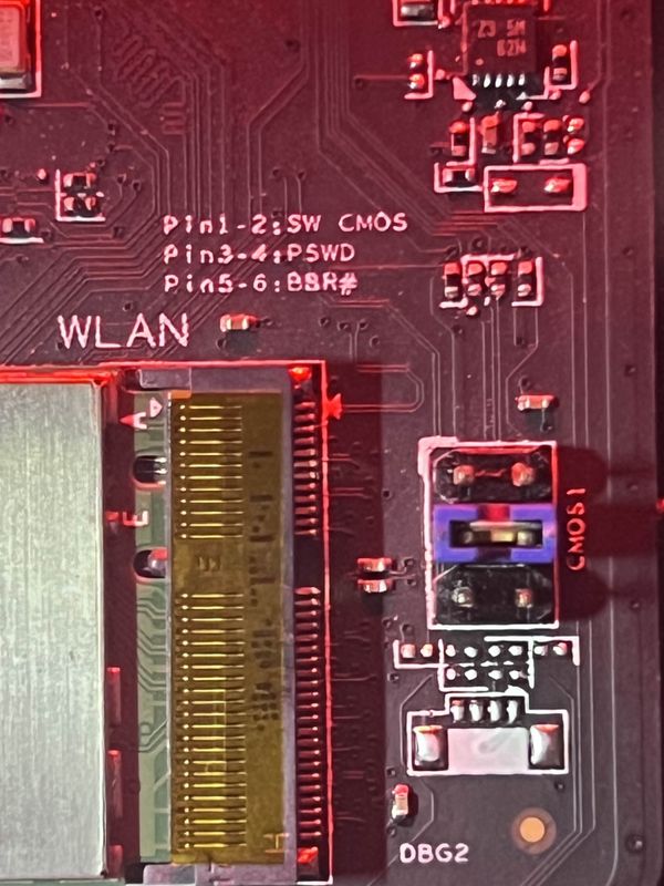

hello, when i boot my pc it says cmos checksum invalid. everyone says to reset cmos, i did. everyone says to update the bios and it is the newest one avaliable. i think it may be related with these two jumpers on my motherboard which i may have moved in the past. my pc also turns on whenever i turn on my surge protector its connected to for some reason, and i would like to know how to fix that too, or if its related to the other problem i am having. i also attached the pictures of the jumpers so you can tell me if they are right please. thanksIMG_7156.jpgIMG_7157.jpg

3. Check Motherboard Jumpers
Verify Jumper Settings:
The configuration of motherboard jumpers is crucial. Here’s a typical setup:
  • CMOS Clear Jumper: This jumper is used to clear the CMOS memory and reset BIOS settings. It usually has three pins with a jumper connecting the first two pins by default.
  • BIOS Recovery Jumper: Some motherboards have a BIOS recovery jumper for re-flashing or recovering the BIOS. Ensure it is in the correct position.
Refer to the Motherboard Manual:
  • Check your motherboard’s manual for the correct jumper settings. If you can’t find the manual, you can often download it from the motherboard manufacturer’s website.
Correct Placement:
  • Pins Configuration: Ensure that the jumpers are correctly placed according to the motherboard’s specifications. If you suspect that you moved them, restoring them to their default position is essential.
