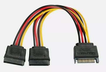

2.) Use what you got.  There are three graphics card options, the best performance/bang for your buck would be a low-profile RTX 3050 with only a 70-watt TDP which does not require any PCIe power cable: https://www.techpowerup.com/gpu-specs/msi-rtx-3050-low-profile-6-gb.b11696, or either a GTX 1660 Super (125-watt TDP) or a GTX 1660 Ti (120-watt TDP) which require one 8-pin PCIe power cable, which you can do by tapping into two of your power supply's 15-pin SATA power connectors to plug in a dual 15-pin SATA to one 8-pin PCIe power cable adapter, which looks like this:
If you don't have two 15-pin SATA power connectors available in your case, you may have to buy a 15-pin SATA power cable splitter:

2.) Work with what you got: the very best three graphics card options compatible with your 300-watt power supply are first and foremost this 70-watt TDP low-profile RTX 3050https://www.techpowerup.com/gpu-specs/msi-rtx-3050-low-profile-6-gb.b11696, which does not require a PCIe power cable, or either a GTX 1660 Super (125-watt TDP) or a GTX 1660 Ti (120-watt TDP), both of which require one 8-pin PCIe power cable, which you can make happen by using a dual 15-pin SATA power to 8-pin PCIe power cable which looks like this:
If you don't got two 15-pin SATA power cables available, you can fix that with a 15-pin SATA power splitter cable which looks like this:

Are the SATA power connectors labeled as P5, P6, or something similar? I see that I have four available SATA power connectors. One is connected to the hard drive, and another is connected to the CD-ROM, which I can discard since I don’t use it much and it’s broken.

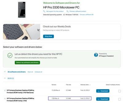

With regard to your BIOS version, I am a bit confused: according to HP, the most recent BIOS version for an HP Pro 3330 MT is 7.06 Rev. A:
Link: https://support.hp.com/us-en/drivers/hp-pro-3330-microtower-pc/5160080.
So, I can't advise you having BIOS version 8.09.

I ran the dxdiag tool, and while I'm not an expert in this area, it clearly indicates that  BIOS version that i mean. Could you clarify what you meant by not recommending version 8.09 for this system? Is there an issue with that BIOS version? I'd appreciate any insight you can provide.
