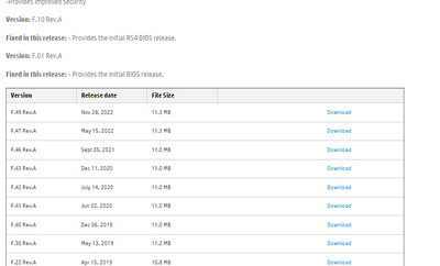

Ya..... I was pretty excited when I actually got it to output to a display finally and made the bios update until it started beeping again. I looked at that link and unfortunately, the older revisions don't appear to have a download by them. Do you know of any other place where I could find the old bios's for download?
07-14-2023 08:09 AM
They are way at the bottom but I suspect there is hardware damage of some type to motherboard.
Good luck!
