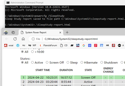

Sleep ReportA list of possible problems ranked asd Errors, Warnings, or Informational
Sleep StudyThe history of sleep going back several days
These report are obtained by using the Administrators command prompt.
Copy and paste the following into the command prompt window for the energy report.
powercfg /energy
.\energy-report.html
Note the number of errors and warnings.
Copy and paste the followind commands into the same window to get sleep history
powercfg /SleepStudy
.\SleepStudy-report.html
I have both reports and i've fixed 3 errors but can't figure out the ASPM and the other 2 say they don't prevent the system from sleeping. So far, i have ALL check boxes checked in Power Management tabs to allow system to suspend device (where available) in device manager, i have set the power to Balanced, set the Turn off monitor to 1 min, set the sleep to 2 minutes and after 1 minute only the screen turns off, fans keep spinning, ram RGB lights turn off but front case light stays on. No power options in BIOS so i assume Win11 controls everything on this PC and no matter what settings, none work. I'm not a PC expert, i'm a car expert but so far, this is way more ridiculous than working on a Tesla or a 1985 F150.

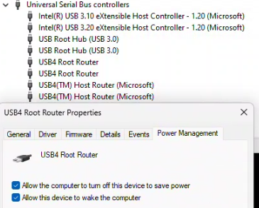

I had forgotten about the diagnostic that checks for devices that can wake up the PC. I should have mentioned it earlier
Run the following command from the windows administrators command prompt
powercfg -devicequery wake_armed
for example the following devices are enabled even if the PC is turned off
They are all drawing power EVEN WHEN LAPTOP IS TURNED OFF.
uncheck the following
 as explained in step 1 here
