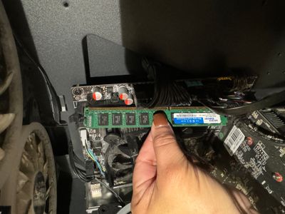

 ok, I took that from there, but my question is, how I am going to add this to another computer, for do the backup
Greetings @Dominicana1016
The image in your post is a stick of RAM (Random Access Memory). It is not a long term storage device.
