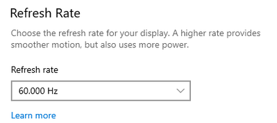

Anyways, what fixed this issue for me, for now, is that I changed my monitor's refresh rate from 165 Hz to 60 Hz:
Please try this, and report back.

The monitor was at 59.95. I changed to 120 and will see what happens. Then move back if still an issue.
Update - changing the refresh rate did not change the problem. Still goes dark but after further investigating I found the screen saver problem was set for 1 minute. I just changed this and will see what happens. AS further test I have a large screen TV set up as a second monitor for zoom meetings or other presentations. Both went dark at the same time.   Will let you know if the screen saver program change makes a difference.
