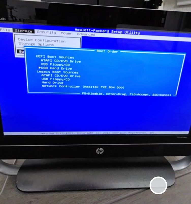

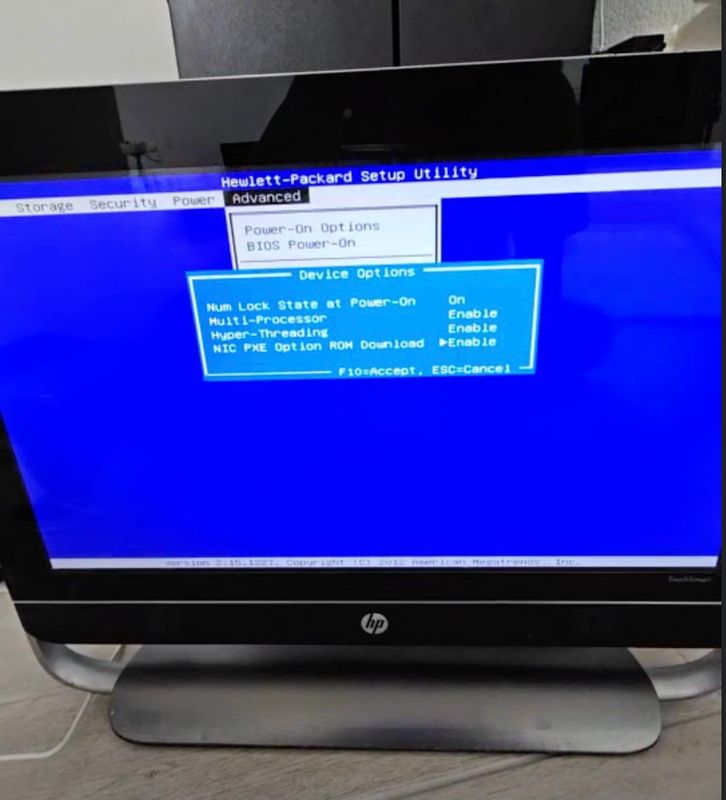

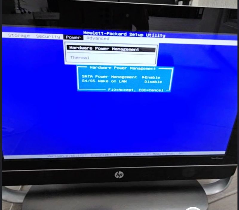

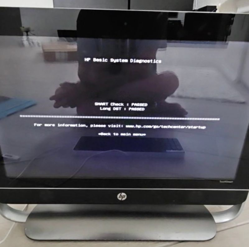

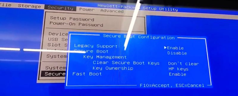

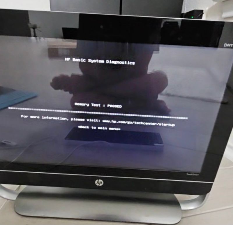

Hello, I am having trouble logging into my desktop. I am getting error messages PXE-E61: Media test failure, check cable and PXE-M0F: Exiting PXE ROM. Error: No boot disk has been detected or the disk has failed. I am attaching pictures of what I have in the settings and did diagnostic tests, they were all passing.

The error messages you're encountering, "PXE-E61: Media test failure, check cable" and "PXE-M0F: Exiting PXE ROM," indicate that your computer is trying to boot from a network device using the Preboot eXecution Environment (PXE) but cannot find the necessary files to proceed. This usually happens when the system cannot find a bootable device, such as your hard drive or SSD, which may be due to a few possible issues:
Boot Order Configuration:
  • Your BIOS/UEFI might be configured to prioritize network boot (PXE) over other boot devices. Check your BIOS/UEFI settings to ensure that your hard drive or SSD is set as the primary boot device.

Hard Drive Failure:
  • If the BIOS/UEFI cannot detect your hard drive, it could be a sign of drive failure. Even if the diagnostics passed, there could still be an intermittent issue. If possible, try connecting the hard drive to another computer or using a different SATA port or cable to verify its functionality.
BIOS/UEFI Settings Reset:
  • Sometimes, resetting the BIOS/UEFI to its default settings can resolve boot issues. You can usually find this option in the BIOS/UEFI menu.

Check the Boot Order:
  • Enter the BIOS/UEFI settings (usually by pressing a key like F2, F10, DEL, or ESC during startup) and check the boot order. Make sure the hard drive is set as the primary boot device.

Run Further Diagnostics:
  • If possible, use another computer or a USB-based diagnostic tool to test the hard drive.
