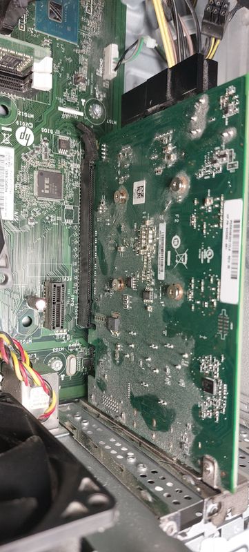

I'm trying to remove my current GPU (RX 550), but I can't unlock the clip. I've watched several videos and tutorials, but they all show different types of clips than mine, so I'm not sure what to do. Could someone please explain in detail how to remove my GPU?
(I know the inside of the case is very dusty - I'm actually cleaning it right now.)Clip_2.jpgClip_1.jpg
That clip does not stay out of the way.  I should have said, while holding the clip to the left, lift upward on the card.  Once it gets past the latching point of the clip, then the card should remain free and you can continue lifting the card from the motherboard.
That end of the video card should clear the clip, then you might need to grip both ends of the card to lift it out completely.

That little tail at the end of the PCIe16 slot is the release.  Pull it to the left and lift the end of the card away from the motherboard - meaning straight up.  The rest of the card can be released by continuing lifting.  I see the screw holding the card at the output end it removed, so the card should come out.

I've already tried pulling it to the left, but I still can't remove the card. Could you send me a video on how to remove it, or an image showing the clip in the open position? I'm afraid of breaking it.
