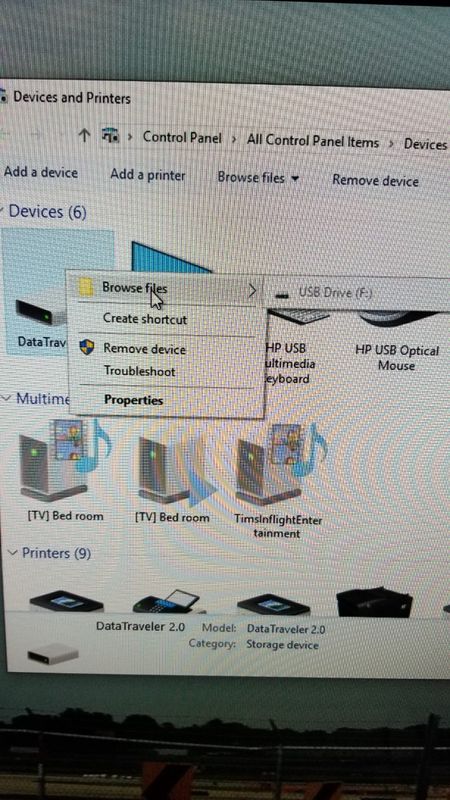

Ok I tried to get screen shots but actually found taking pics easier.desktop 04.jpgdesktop 02.jpgdesktop 07.jpgdesktop 07.jpgdesktop 05.jpgdesktop 06.jpgdesktop 09.jpgdesktop 08.jpgdesktop 13.jpgdesktop 10.jpgdesktop 11.jpgdesktop 07.jpg I will try and put in a normal order. Now I connected a USB memory stick 2.0, a microSD card, and a external harddrive. Hope these pics make some sense.
@tjcoy747 Tim, when you click on browse files from the last screenshot, does it open the folder to the "F" Drive? If yes, try the below steps:
  • Press “Windows”+ “R”, type “diskmgmt.msc” and hit “Enter”, you will access Disk Management interface.
  • When the hard drive is not showing up in File Explorer but appears in Disk Management, you can try the following methods.
    • When the external has no drive letter, it will be invisible in File Explorer. At this time, you should assign a drive letter.
    • Firstly, right-click the partition that doesn’t have a drive letter and choose “Change Drive Letter and Path...” Then click on “Add”,
    • choose a drive letter and click “OK” to give it a drive letter.
    • After that, you can access the hard drive from File Explorer.
  • When the external hard drive is not initialized and appears as an unallocated space or without showing disk capacity, you can initialize it as follows:
  • 1. Right-click the hard drive that needs to be initialized
    2. Select “Initialize Disk” and set the disk partition style as MBR or GPT (check what your other drives are set us, under properties)
    3. Right-click the disk and choose “Create New Simple Volume”.
    Notice: As initialization will cause data loss, you’d better backup all the important data on the external hard drive using another computer before initializing it.
