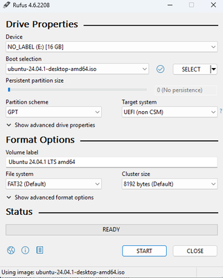

Your system is supported at HP only with Windows
That being said, possibly the following might help
Make sure your USB is configured to  boot UEFI
I suspect that your Linus OS can boot but not install unless the OS asks for missing Intel drivers.
You may be lucky and your distribution includes the Intel drivers needed to enable the NVME controller.
If not then look in to installing the nvme drivers
There are other option such as installing Proxmox in VirtualBox
Your 800 G9 has client recovery to restore win10/11
