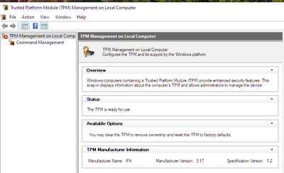

Windows 11 Support with the BIOS.  how to enable TPM required for Windows 11 ??
Please provide screen shot as the information from HP support is relevant to newer BIOS and it is not the BIOS that in inclued on the HP Compaq Elite 8300

It was in the BIOS settings as Virtual Trusted Platform.  I have included a screen shot from windows 10 showing TPM v1.2
