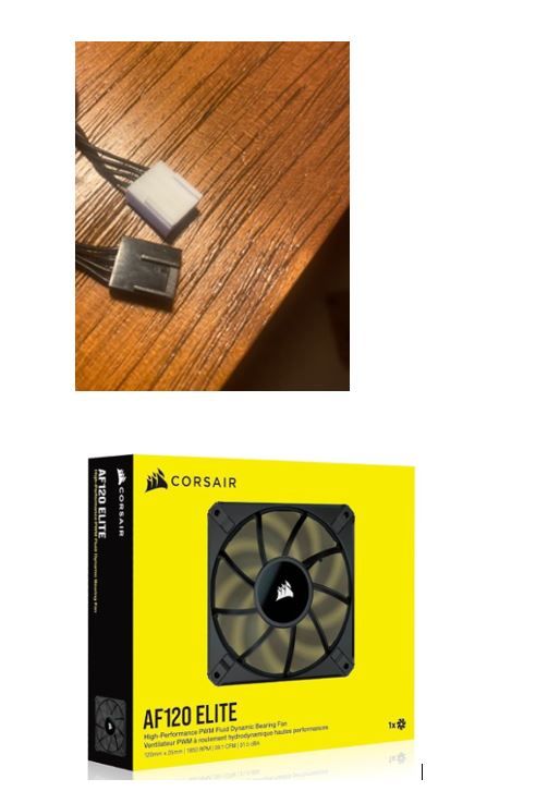

Hello NonSequitur777, Thanks for your support on this problem, I really appreciate it !!!
I ordered a fan that looks like your recommendation ... but the 4-pin connector (black on the picture) has different plastic guides than the HP one (white on the picture). I can't insert it
Do you have any idea if I can use an adapter?
