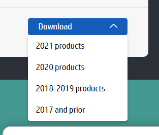

Perhaps you might find the 4-in-1 USB bios
https://support.hp.com/us-en/help/hp-pc-hardware-diagnostics
click on "Diagnose and other potential issues" and use the release date for the 800 G2

I have not looked at that 4-in-1 in some time but I think it is organized by bios rom family as I saw a lot of 4 and 5 character file names.  They are all rom and sig bios files
hope this helps
thank you for providing these links BeemerBiker but I'm still have no idea how HP identifies their files with few letters and numbers which is making me confused and have no idea which file is for which board!
is the file name resembling part of board number or am i missing something?
