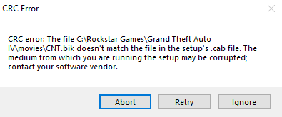

I get CRC Error in EVERY installation
And GTA iv in that photo attached blow its just an example
I get this error on any installation or even Extracting files

get CRC Error just like that photo
; "filename.xxx doesnt match ..... corrupted and bla bla bla "

What can i do ;( ????Annotation 2021-07-29 203019.pngAnnotation 2021-07-29 203019.png

@Avenger_007 -- how many sticks of RAM inside your computer?  If more than one, remove all-but-one, and try again.
Yes, the Installer will not work as fast, but if that stick of RAM is "good", then you will be OK.
If you still get "CRC-error", remove that one stick, and insert a different stick into the same RAM socket. Try again.
If you still get "CRC-error", move that one stick to a different RAM socket, and try again.
Or,  download/run a bootable RAM tester, e.g., Memtest86+ - Advanced Memory Diagnostic Tool
with all the RAM sticks installed.
