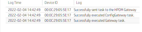

Hi everybody,
I have installed HP Device Manager 5.0.7 with HPDM Gateway v5.0.3630.39035 on a WS Server 2012 R2
Im trying to turn on TLS 1.0 on the HPDM Gateway
I set it on the configuration of the HPDM Gateway and select ok
Task run correctly
But if I check the configuration, nothing changed
I tried to restart all the services and the server, nothing changed.

I tested this on my HPDM 5.0.7 and did not have any trouble to enable TLS 1.0. Make sure that HPDM Console is closed and no task are being send while this step is tried.
From the HPDM admin guide it does not look you will need the TLS 1.0 since this was required for HP Thin Pro 5 OS. HPDM 5 does not support anything below ThinPro 7. You can find this in the release notes, I could only find the release note for the latest HPDM 5.0.8, you will find the compatibility list under HPDM Agent requirements on page 9
https://ftp.ext.hp.com/pub/hpdm/Documentation/ReleaseNotes/ReleaseNotes_HP_Device_Manager-5.0.8.pdf
HPDM 5.0 onwards HP has enabled HTTPS Server for Repository which is compatible with Thin Pro & Windows. This is auto configured during the installation reducing the time to configure FTP/SMB separately.
