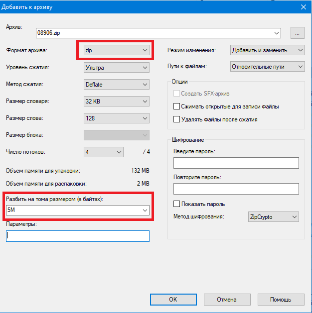

03-18-2022 02:45 AM - edited 03-18-2022 07:16 AM
Can you archive a file and split it into parts, for example, using a free program 7zip and download it here in 2 posts?
03-18-2022 03:16 AM - edited 03-18-2022 07:05 AM
I found file 08906.bin in the Internet, but not sure if it is correct.
It has SHA256: 87518C1630D6303854017FB9AD80AD0A1B5140EE35629AE0909C2D22A584834E and size 16777216 bytes (16 MiB).
Can you check the checksum (SHA256) of your file 08906.bin?
If it is correct, I would ask you to share only 08906.sig
