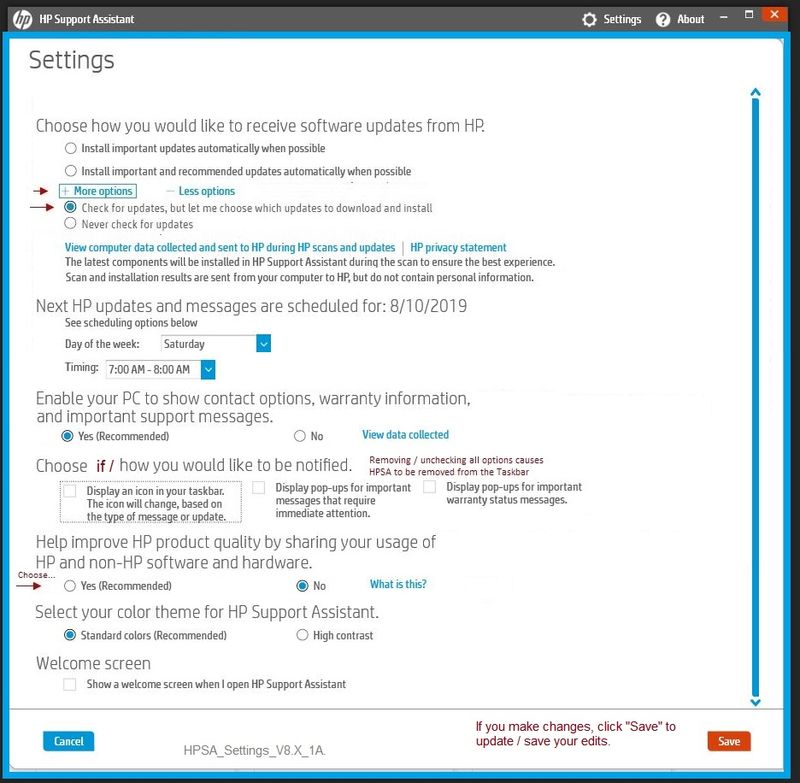

Open HPSA Software
Settings > Set to “Notify” as opposed to “Auto-Update”
Save Changes > Restart the computer and log in
Open HPSA
Check for Updates > Use the list to determine candidates for update
If BIOS is offered, set to “ignore” or otherwise remove from list of potential updates
Install other HP software and updates using HPSA or manually install those updates

If  you can at least get HPSA working in "Notify" mode (as opposed to automatic updates, for example), you can use the list of potential "Check for Updates" list as a "checklist" to help you manually look for new Updates at your computer's Software and Drivers website.
General Example - HPSA > Settings > "Notify"
