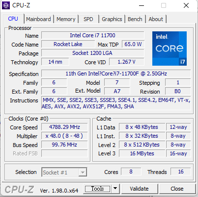

I bought OMEN 25L few months ago, there is a problem is the cpu overheating problem (usually 85-90+ degree in game, gpu is fine) so would like to do undervolting on it. My specs are Intel i7-11700F and RTX 3060ti, Recently i found that that there are overclock and undervolt options in Omen Gaming Hub on the internet(youtube) but i can't see these options in my hub. Why i don't have the options? Also the cpu is locked, how can i undervolt or are there any better ways for me to reduce cpu temperature? (btw i tried to lower cpu maximum processor rate to 99% but i suffered a great loss from that as my cpu base clock suc)

CPUZ shows you are running at full turbo speed: 4.7 ghz maybe all the time
you might check your advanced power setting and see if the minimum speed is 100% and change it to about 50 so it drops down to 2.5 which is the normal speed rate for your CPU (non turbo)

Download CPU-z and run the program.  Look for cores and threads.   If you see 4 cores and only 4 threads then hyperthreading is already disabled.
The following pictures shows 20 threads and 10 cores so this system (Area51) has it enabled.
Oh, sorry my fault. My cpu is i7-11700F but not 10700F, and there are 8 cores and 16 threadsi7 11700F.png
