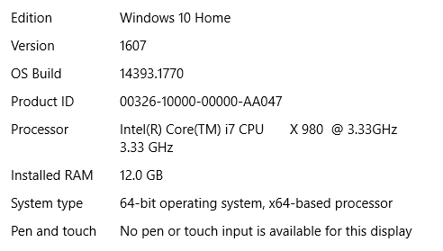

My Desktop PC appears to be stuck at Version 1607 (OS Build 14393.1770) my laptops
have installed a newer Creators Update. I need version 40 of Edge. Any ideas?

Maybe I did a poor job of explaining the problem. I have been using Windows 10 for the last 18months. On my desktop I see this DesktopCapture.PNGDesktoUpdateCapture.PNG
My hp laptops have all loaded the Creators Update and have Edge version 40. This pc has not loaded yhe Creators Update.
WDG
Do you use Spybot Anti Beacon or anything similar that blocks telemetry? No My desk top has the same software as my laptops -- all HP and the laptops have all loaded the creators update this desktop has not. I nee Edge version 40 which comes in the Creators update.
