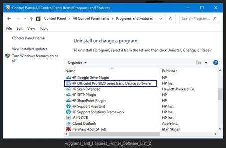

Printer Software
Check that the full driver printer software is installed in Control Panel > icon view > Programs and Features
The name of the software might vary slightly from one model of printer to another - normally, the printer software does contain some form of the printer model name.
Example
Programs_and_Features_Printer_Software_List_2
If the printer software is not installed in Control Panel > icon view > Programs and Features,
Install the full driver printer software.
If the printer software is already installed, you can certainly use it - scroll down to see the example of the Desktop icons.
