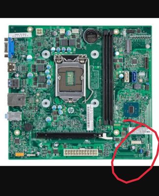

ok so my problem is, im just swap my psu on my system and i cant seems to find the power switch and other 2 pin connector on my hamar motherboard, can you guys show me where it is?

A picture of the mother board is here
https://www.ebay.com/itm/164867013387?hash=item2662d6fb0b:g:hxMAAOSwCTlgnw-Z
Do you have the same cables? Which ones are giving you a problem?
03-02-2022 03:14 PM
@Nadha78 -- is this a (fuzzy) image of your motherboard: https://support.hp.com/doc-images/56/c05068252.jpg ?
On your motherboard, look at the white-coloured "block" with two rows of pins, near the bottom right of the image. That is where the two wires from the on/off switch should connect.
