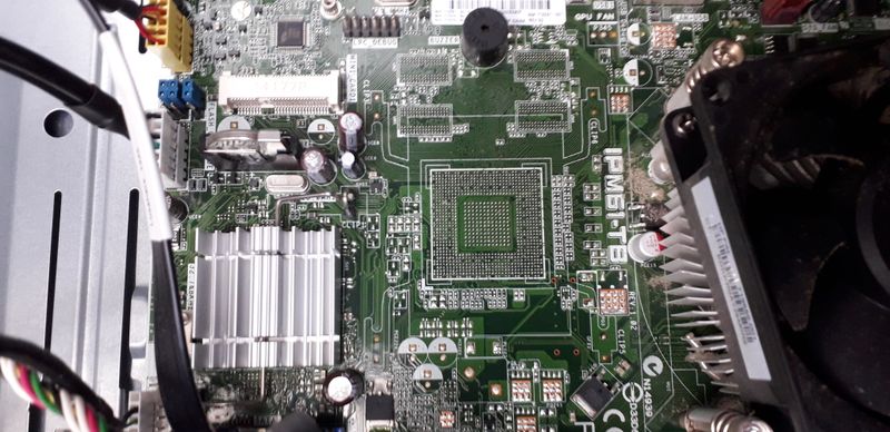

An example here of a motherboard installed on a pc of the series: hP 110-300
Photograph of motherboard
present here
if there isn't, I'm curious how long the computer can stay unplugged.
It will obviously be necessary to open the bios in order to set the clock if it is no longer on time

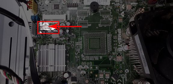

Its sideways, not laying flat...

Hello Photoray002.
Thank you for your response with the attached photo.
I had not located the location of the battery.
Battery changed.
Big thanks
cordially.

we had succeeded in identifying the motherboard, there it is better with the photos!
the model of the CM, we can see very little here the battery:
Motherboard Specifications, IPM61-TB (Tenby-U)
