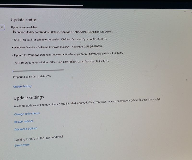

mr2.jpgCurrent issue- After getting windows installed from W7 to W10 Pro, its failing to install whats in the updates in the picture. It shows a code of 0x800705b4 and says it had trouble installing some updates & will try again later. After a few restarts and a few updates during shut downs it still refuses to install whats in the picture and gives the same code. It will take a minute to find the updates then when I click install/retry it stays at 1% for about an hour before going back to the same message of well try again later. After all day yesterday getting w10 installed properly the update issue continues.
I am unsure of what steps to take next to remedy this. Side note, AMD Catalyst did show up and says it needs attention to make sure videos function properly with 3rd party add-ons, doubt thats the issue though. Any help would be greatly appreciated

Have you tried running the Windows Update Troubleshooter (Link)?
I would also run a CheckDisk (Link) to make sure system files are good.
Check out this Microsoft Community solution (Link) to this problem.
Regards

Thank you very much, That helped and seemed to fix the issue for he final update. It now shows system is upto date.  The option for the check wasnt present until some of the updates took earlier this morning. It seemed to fix it and now says its up to date but I have a new concern.
The very last update that refused to install was a windows defender and now its showing my TPM is not active and saying the device installed is not able to run it or support it. I guess thats another issue to post in a different catagory.
Im not sure why this is showing up as I ordered everything from HP and installed using methods from HP techs. I have a feeling it has something to do with the secure boot being turned off at one point to install the new hard drive. Thank you for your post!
