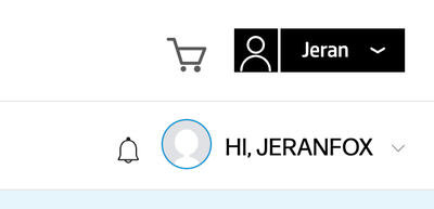

Thanks for the reply @Irwin6, unfortunately there is no little blue envelope next to my profile name.
When I click the link you posted to go there directly I get this error message:
Hi @jeranfox,
I have shared the details again. Kindly check.
