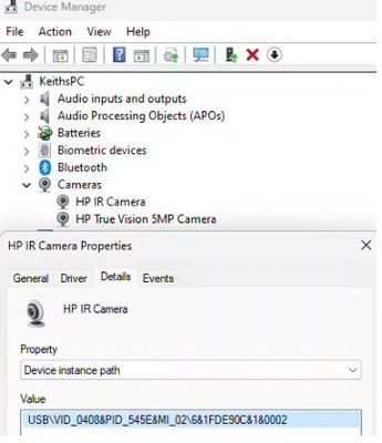

My Device Manager list doesn't even show the camera. So, I can't find the info about the driver. This is a built-in camera that came with the computer. I haven't done anything to it. That would be beyond my skills. For a while it was glitchy and I was able to fix it. Then it just completely stopped.
Bring up the device manager and select the "show hidden device options"
see if you can find the name of the camera so it can be looked up.
The best I can come up with is Volfoni from looking in a parts list and I cannot find drivers.
==that was name of system, not camera
If you find a hidden camera device, what is its "device instance path" ?
[edit]  I am guesssing is is made by realtek and might be in the audio driver

When I go into Driver on the Properties the "Rollback Driver" feature isn't available. Here is the Details shot which appears to be the same on both cameras.
Lets try a couple of other things first

Your cameras are listed and are not missing from the device manager.  If there is a red or yellow icon then windows knows there is a problem.  All I see is that they are not connected.
