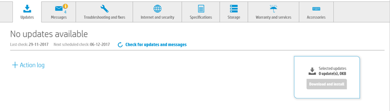

Touch screen is not working for Product ID: 00342-41309-13692-AAOEM.
Device ManagerDevice ManagerNo Updates foundNo Updates foundProduct detailProduct detail
